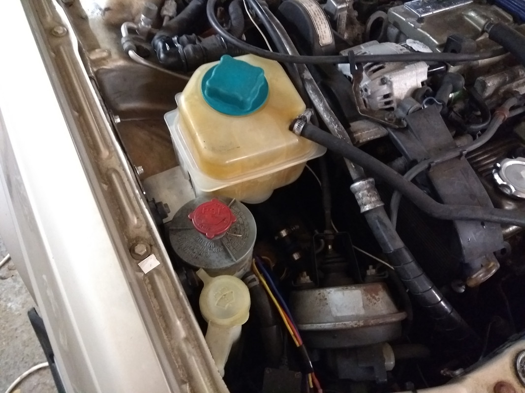

I would also dearly like to find a good genuine radiator expansion bottle too. I have had to resort to using a Volvo one, which works well but looks wrong under the bonnet.

There are no good, new expansion tanks available now. Last two i heard of that were sold went to the same person and both failed in very short order. His car deserves the title "Garage Queen" as it really is immaculate inside and out (you could eat your dinner off the engine as long as you cleaned it to the same standard afterwards!) and doesn't do many miles. Hence for both of the new tanks to fail so quickly they must have been very poor!
I am currently looking at producing an aluminium expansion tank in the style of the original. It won't be a perfect copy but will be nearer than the Volvo conversion although the Volvo conversion doesn't look that wrong :
That said if you're using the older style torpedo tank, they do look a bit out of place.
If the aluminium one works out, i'm still struggling to find the original filler neck. I've found different ones that are for the "traditional" caps but none that are a direct equivalent to the Rover/Volvo thread.

The other thing that I find interesting, is that my son's 1988(Mk1) 827Sli has the earlier radiator expansion tank, with the level detector and Max/Min level markings only half way up the side of the original expansion tank. That tank is still as good as new, with no signs of cracks or bulging. That car has never shown any signs of overheating, or requiring top-ups between services. Makes you wonder whether the later models much higher levels required, actually overstressed the tanks badly.

Try a new cap on the expansion tank Adrian, could easily be where the coolant is going.
As for the tank on your sons Mk1, that would be about right. On the Mk2 tanks, they no longer used virgin polymer to make them so they were inherently weaker. If you look, the Mk2 tanks have a sort of "marble" stripey effect inside the polymer yet the Mk1 tanks are uniform in their clarity.
The marble effect is re-grind plastic that's already been used and has been ground down into granuls again to be recycled. It weakens the whole thing.

I agree MK2 tanks are not the same quality as earlier ones they leak all over the place especially the top section. Also worth taking the engine cover off and look into the v see if your losing coolant from the stat or pipe that goes to the water pump this is a common one on the kv6.

I do have an original expansion tank but it is rather suspect and if I fit it, I doubt if it will last long. I guess in the meantime I will continue to use the Volvo one, which does appear to be much stronger. I have filled it to the level marked on the tank, but not too sure whether that is correct, or not.

I'd stick with the Volvo tank Adrian, i've been running one for 12 years now with no problems - sometimes i was lucky to get that many days out of the secondhand Rover ones i tried at first!
Then i had the idea to use a Volvo one and went back to the same scrapyard and bought one - the rest as they say, is history!

I suppose I could keep an eye out for one out of a Series 1 800. That would look right and should hopefully last better than the later expansion tanks.

The early MK2 tanks are very rare indeed I have one on mine which is very good as it doesn't allow air in or water out which then cause loads of kv6 problems mainly hgf.so if you can't find one stick to the Volvo tank idea it works and should solve those underlying problems that we get with these motor's
