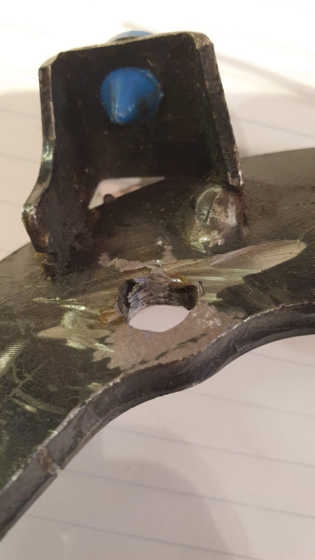

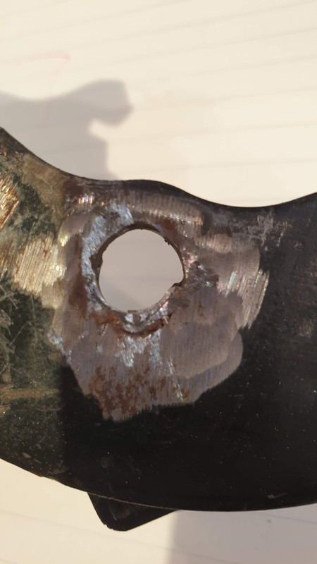

As my dash-swap continues (see here: http://www.rover800.info/forum/viewtopi ... 37#p155337), I though I'd take the chance to get my clutch pedal out so I can take a trip to the bearing factors tomorrow
LOOK AT THE FLIPPING STATE OF IT
It looks like someone's been here before with an angle grinder

Post by scoobyh123 » Fri May 22, 2020 9:53 pm
Eek! :shock:
Definitely looks like someone has "tried" fixing it in the past! I didn't save the last spare one i had because mine are (or were) all auto and the majority of the V6s are. Don't know if anyone is breaking any 800s on ebay but might be worth a look.

Wow. That was seriously worked upon with a hacksaw. If you can’t find another pedal and have access to a welder you should really fill it up, grind it down and re do the hole. A Bush is obviously larger so it could work with enlarging the hole to fit a larger Bush.
Sadly, I don't have a welder. I had thought about getting a garage to just plug it for beer money, but then the hole would be governed by the quality of my 'hand held drill whilst the pedal sits on a garden table' efforts. And I'd probably struggle to get the hole accurately located as well - I don't have any data points.

Fingers crossed they come back to you with a sensible price for a good clutch pedal! Definitely looks like Dewhursts worked on that pedal previously, no knowing where the hole should be as it looks like it's already been filled with weld and then the excess cut off with a hacksaw! :shock:

scoobyh123 wrote:
Sat May 23, 2020 10:47 am
Agreed - that's exactly what I think happened.
Thankfully, I've fixed it!
The pedal feel has been transformed, although obviously the real proof will be in the driving, and I'm a few days away from that yet.
I took a trip to (a few) bearing places, and in the end a very nice guy gave me one of these:
https://www.ebay.co.uk/itm/283294138857
I got home, drilled out the misshapen hole to 11mm + a bit, then used the vice and a socket to press the bush in. It slightly distorted because the hole I'd made wasn't quite 12mm, so the clevis pin would only fit if pushed firmly. So a very, very light touch with an 8mm bit to the centre of the bush and all is good.
Very pleased with that.
