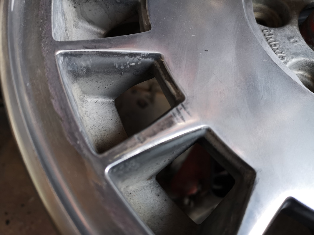

Thanks, the centre cap is in fact plastic and i've had a couple of nasty surprises as i've continued with the clean-up/polishing.
Not only was the wheel originally rough-cast with 3 coats of primer (etch, filler and normal), 2 coats of colour and at least 1 if not 2 coats of clear and then baked on (enamel baked at 140C! :shock: ) but they used some other filler in a couple of gouge marks on one of the spokes before painting it.
The gouge marks are deep (3mm+) so have no chance of polishing out and there are a couple of areas (admittedly very small but very noticeable) where the primer still refuses to shift, even after sandblasting, a rotary wire wheel in the drill, a small screwdriver used as a scraper and a few other methods.
That means even if i do get rid of those last traces of primer, i've still got this to deal with :
Only thing i can think of is fill and paint it which defeats the object of polishing the front face of the wheel.
I'm glad it's only the spare, i have a sneaking suspicion i'll find similar on the other wheels so might just alter my plans and paint them. Jury is still out at the moment! :wink: :D

Decisions decisions, if you paint it then you will have to paint all of them, but if it is only the spare then those scratches on the spokes are fine, a lot of work otherwise.

I've decided to fill the gouges and paint the wheel Jim - as it was a random choice out of the 5 wheels to strip and refurb and i found these gouges after removing the original paint, it doesn't bode well for the others - took me long enough to get to this point and if the others are in a similar state then it's just too much work.
