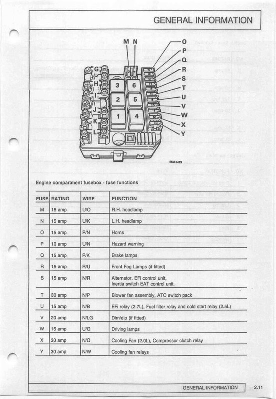

First question Adiran - has the cam timing been corrected yet? No point throwing parts at it if it hasn't, then there's a couple of other things to check and do first.
If it has, remove fuse "S" from the engine fusebox for 5 minutes then replace. Then perform a stepper-motor reset.

I suspect MEMS learned the fueling needed for the incorrect cam timing and now it's correct (i hope!) it's having trouble re-learning where it should be, hence the reset by pulling the fuse for a few minutes and the stepper-motor reset.

Also once fitted do the fuse "S" thing so the ECU is back to a clean slate again.
