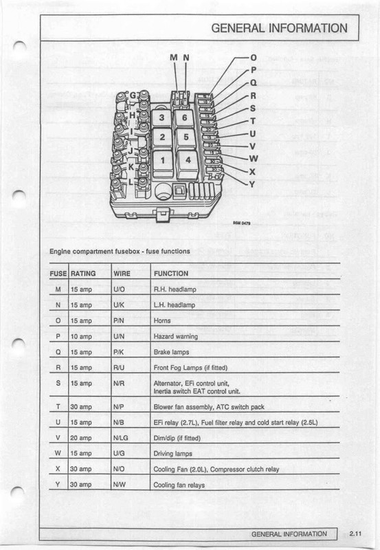

If you remove fuse "S" from the underbonnet fusebox for 30s it will reset the ABS fault codes and also the engine ECU. As it's a MEMS ECU, it will take anything up to 200 miles to relearn/tune the idle andsome running trims but it's better than the other method of switching the ignition on/off 20+ times with the diagnostic link connected to the brake pedal switch!
