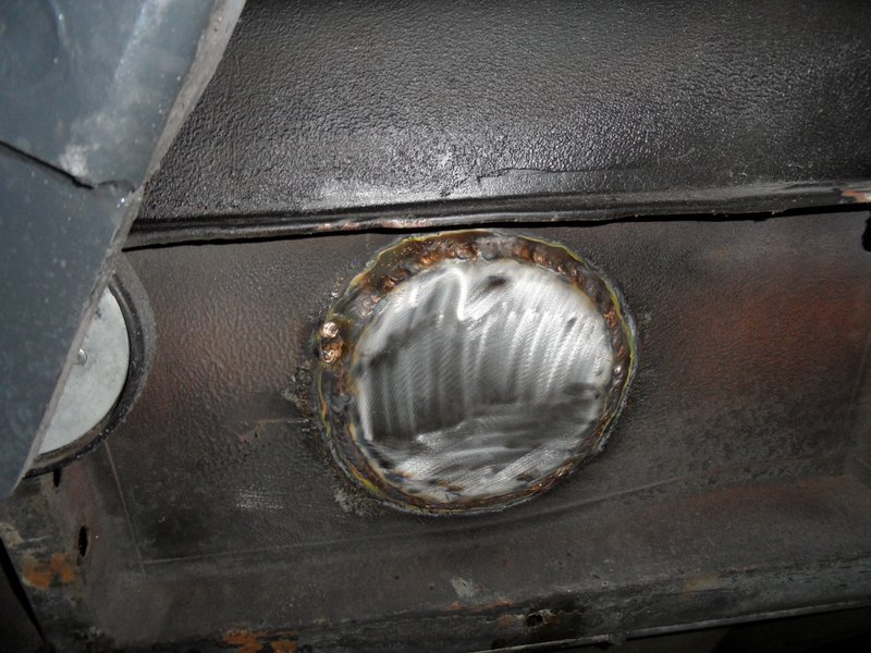

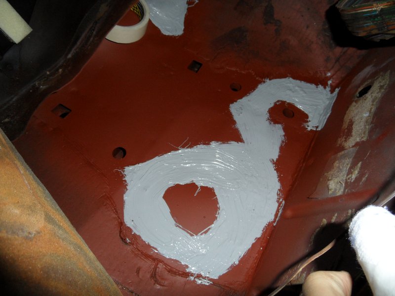

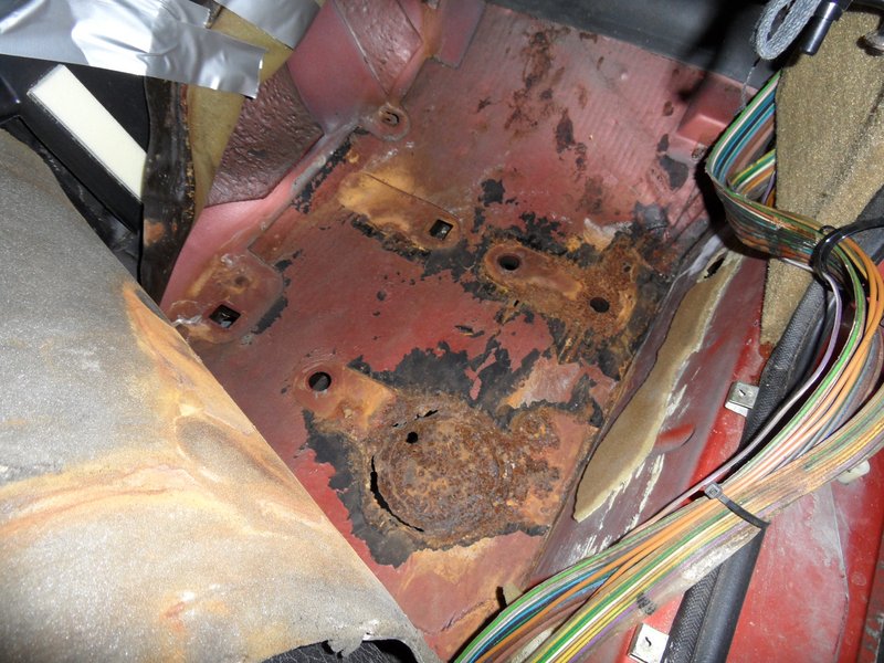

This was the floor on the right side. The left side was almost as bad. On a few places it rusted all the way but the main area was the circle. It looks worse than it was because of the rusty moist that got in and left its colour around the car. Besides the rotted circle there were some holes that i welded shut with a plate or with the welder.
I cut out the circle bigger and made a new circle of fresh steel.

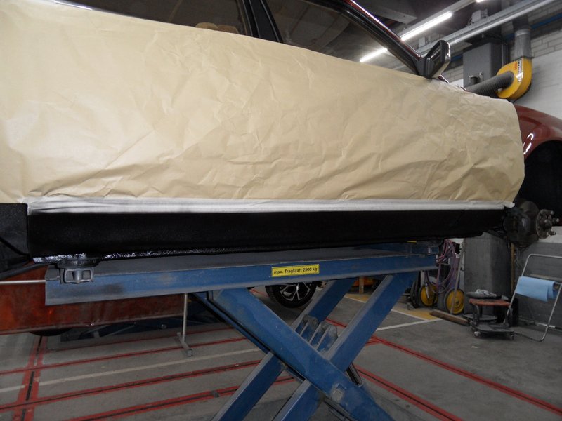

This circle was welded from the bottom. Because fire is a hungry and fast ellement i covered the interior to be sure no fires could start. Also a mate was present so that he could help with pressurized air or a fire hose.

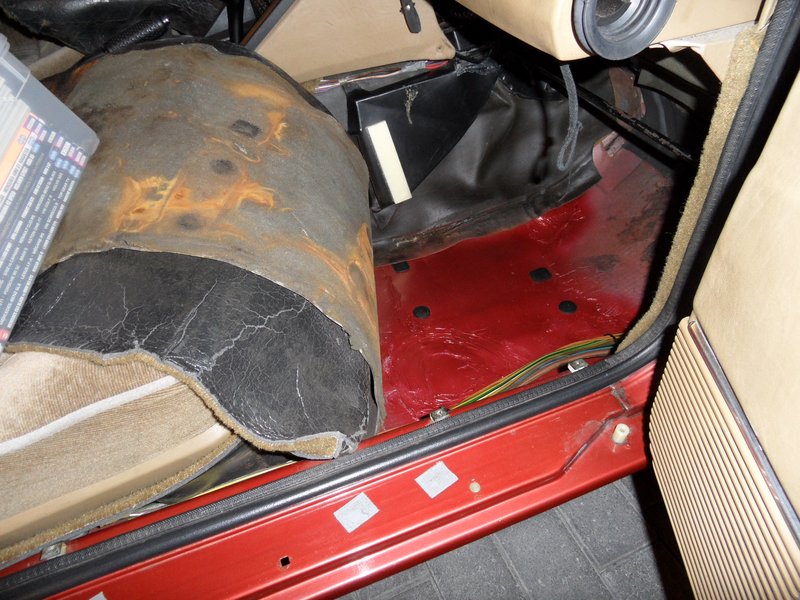

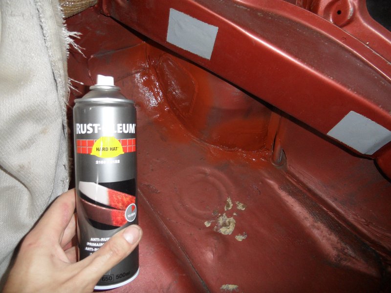

After this is applied a rust preventive primer and sealed the seems with sealent.
Right side:
Left side:
Additional primer so i could apply colour:
Coloured and old plugs re-installed. Every thing was cleaned after all the work.
Because i had to remove the old sound deadening i installend new one:

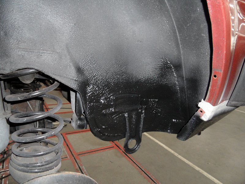

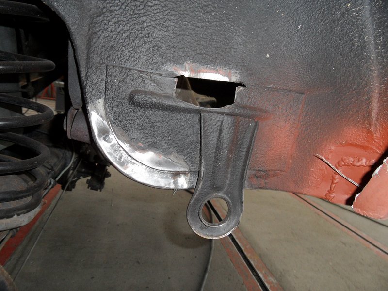

Next place was the left rear wheel arch. The edge behind the wheel spat was completely rusted away. I had to make all the parts new.

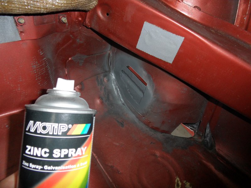

From the left rear wheel well you could see the inside of the boot.... Not good! Behind the towing eye rust formed.
First i cut open the steel from the boot. After i cleaned the steel properly i applied zink coating on the inside of the outside plate.
After this, i welded a plate and applied rust preventive primer:
After this again used sealer to make sure everything is sealed.
Then i welded a small plate on the outside and coated everything with body coating:

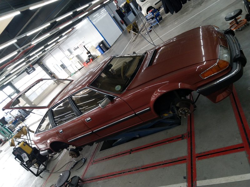

The old boy looked like this during the last weekends:

Boot first sealed with sealer and then primer so that i could apply colour:

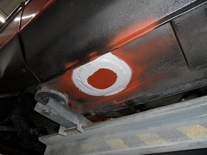

Now i took a picture of the end result of the cirkels that i welded in:
