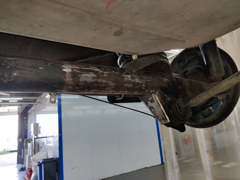

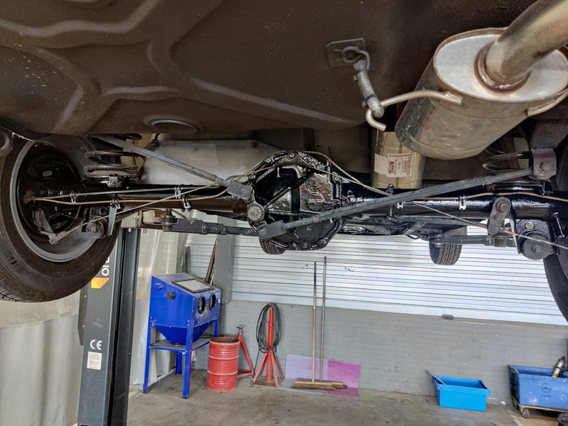

I noticed the rear axle had some surface rust. Nothing weird but i like it to look as good as it can. I really like this stuff to make the underside look nicer:
Worst of the rust removed:

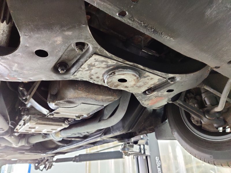

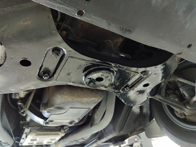

There was also some surface rust on the front subframe. I was busy anyway so tackled this as well:
Easy to apply and cures rust:

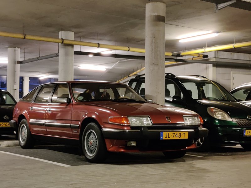

Because we were planning a big trip in the old SD1 i tested it in the past time. I noticed a minor coolant leak/ussage that i just could not place. I went to my mechanic/friend to help find it. He told me that he thought the expansion tank cap is the reason here. It did not fully close so when the fluid rise it just went straight out the overflow. We installed a new cap and problem solved haha. Easy fix!
So, a big trip? Oh yes we like to use the cars for big trips. I always liked the idea of taking it back to Switzerland to show it to my friends there how it looks now.
Sunday the 14th we took of to our overnight halt in Sinsheim Germany:

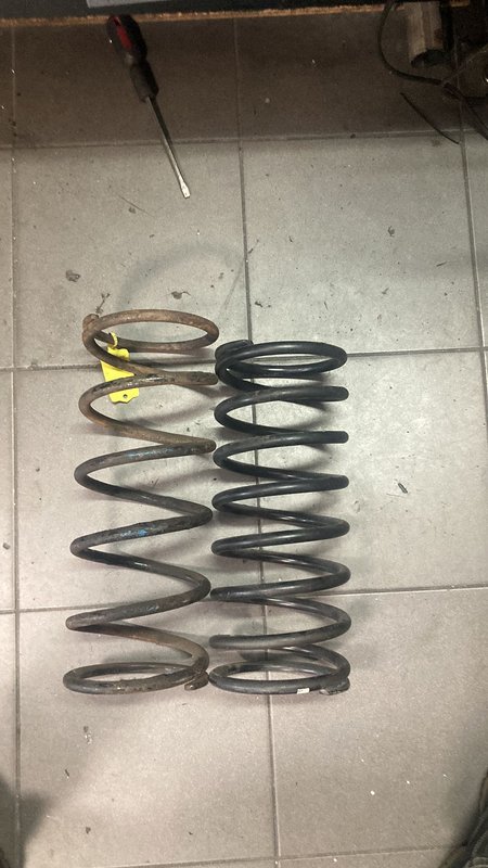

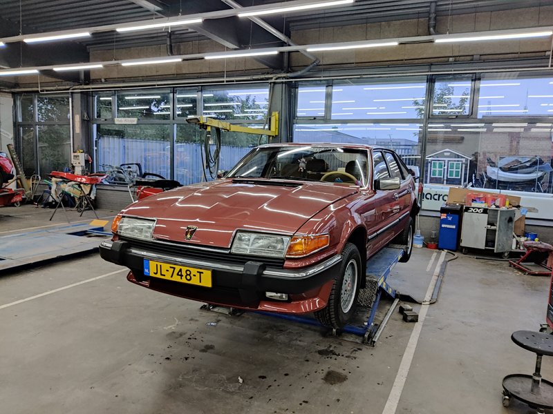

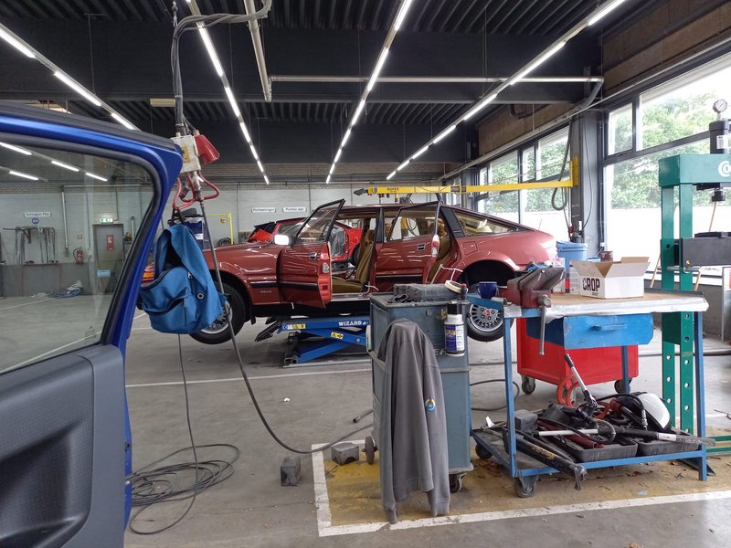

Another thing that bothered me solved! A few years ago i had the springs and shocks replaced. I ordered at Rimmer brothers and everything fitted oke. But the front height never looked correct and it felt like it reached the end of the spring sometimes. When i was in Switzerland i had a look at the collection of SD1's owned by my friend. I noticed the spring that was fitted to my Vanden Plas had to many coils. When compressed it would be full faster than the orginal ones. When we got home i contacted a Rover parts supplier in the Netherlands who supplied Rover 3500 (non Vitesse) front springs.
The left one is an original Rover spring. Stronger and with less coils:
Everything fitted by my mate and heading home. A lot more comfort and it all felt more into place. Difficult to explain but i am sure you understand.
My wife in het loyal Mitsubishi Colt. Great little car:
Back home. Now i notice how much the low front annoyed me. This looks much better i think:
Another cosmetic job done.

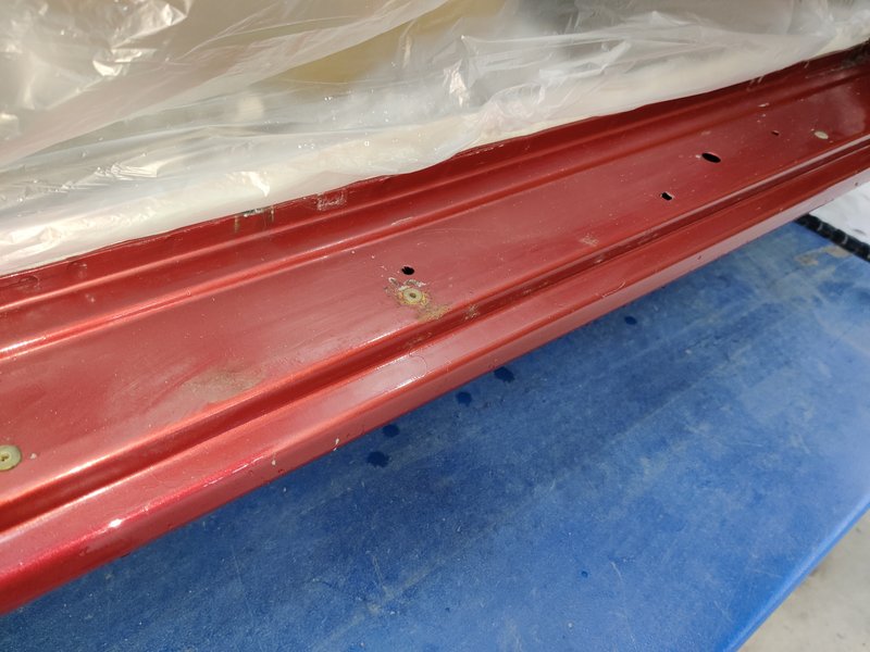

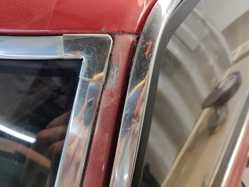

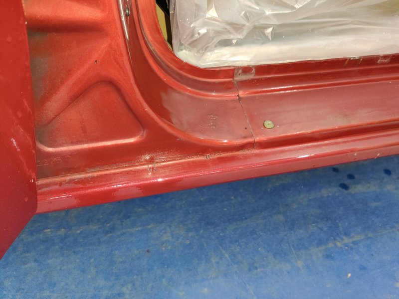

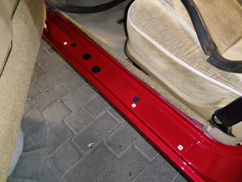

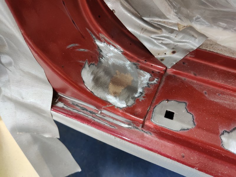

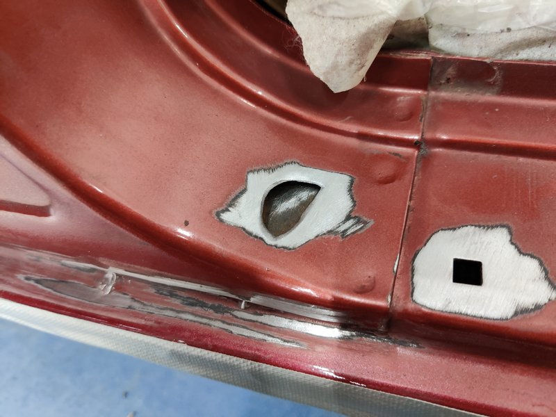

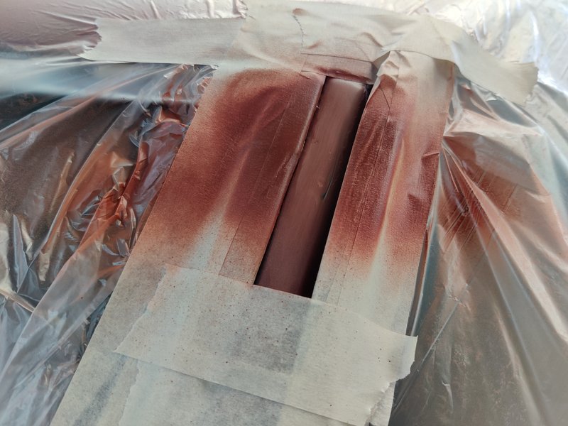

On the sills there were some rust spots. It looked so tatty so i had to do something!
Left front B-pillar:
Left rear:
Right rear:
Right front:

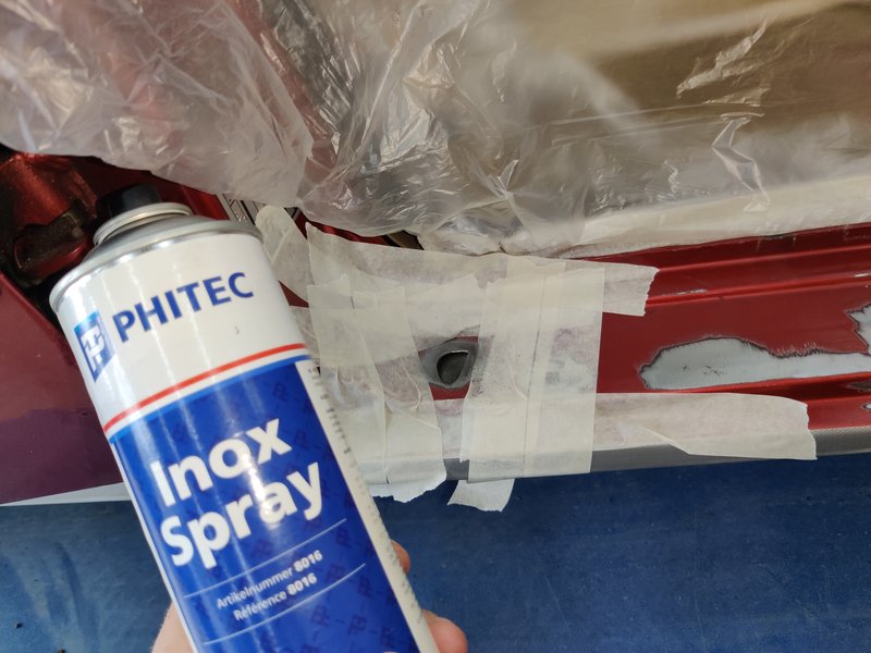

At the front right i even found a hole. I made it bigger to make sure the rust was gone and to make sure i could clean the inner sill. Removed the rust and vacuumed out the rust/dust from the inside. On the inner sill there was only a bit surface rust and that was easily removed and threated:
I applied rust killing welding primer on the inner sill:

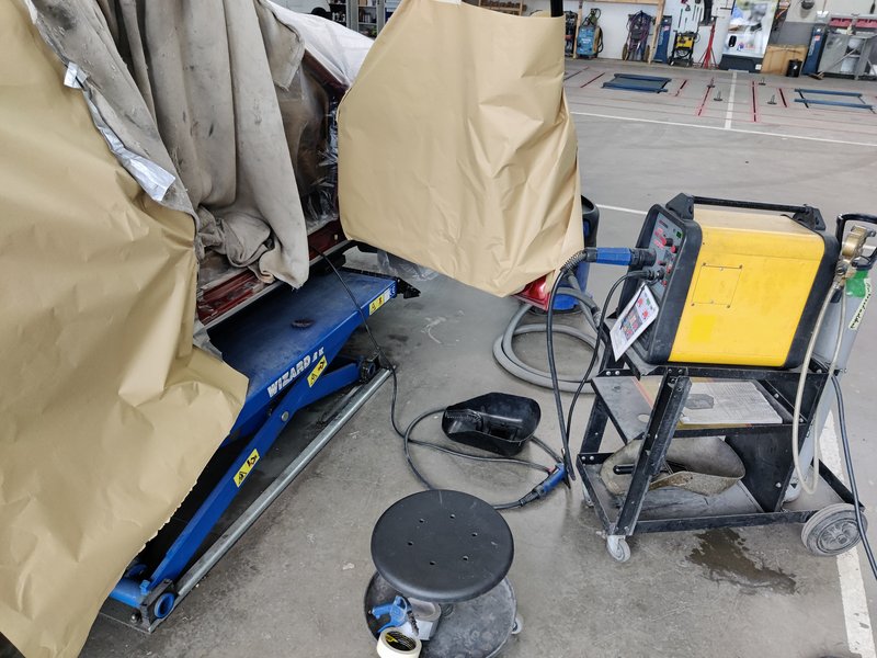

Everything protected and covered. Then is could start to weld:
Easily closed and grinded smooth:

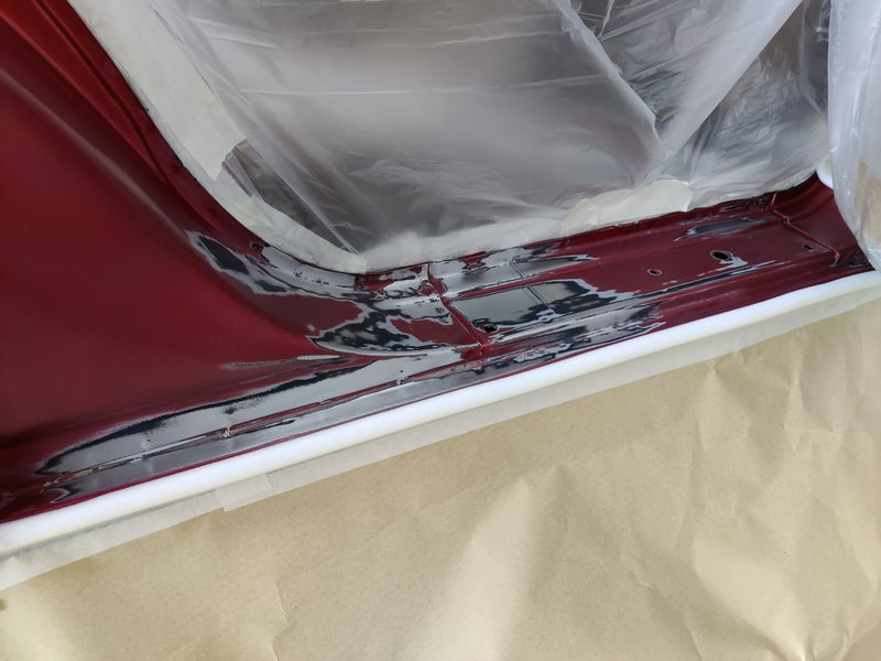

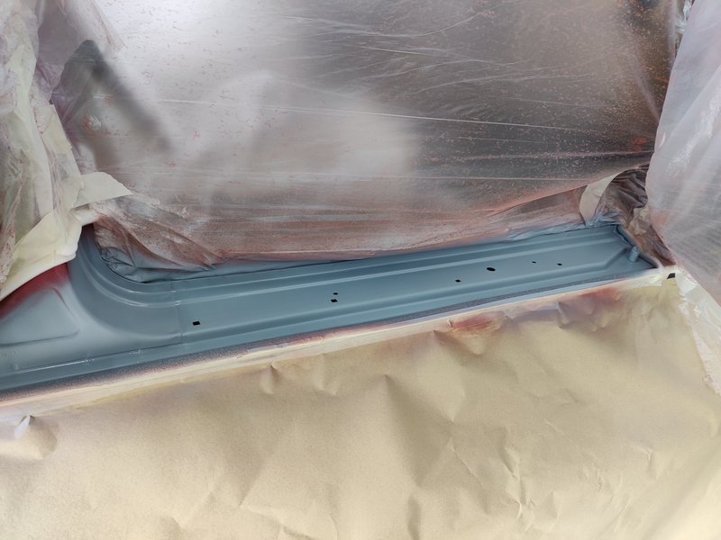

Then i sanded every sill and prepped them for paint:

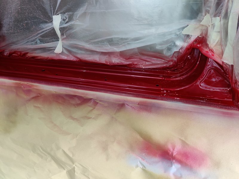

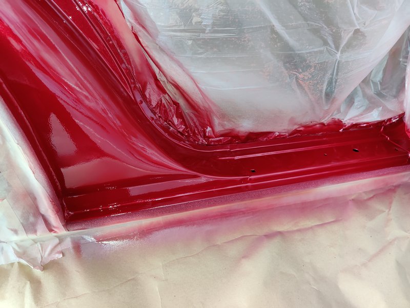

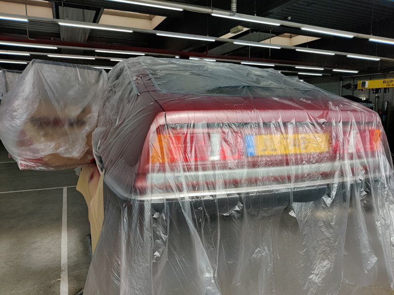

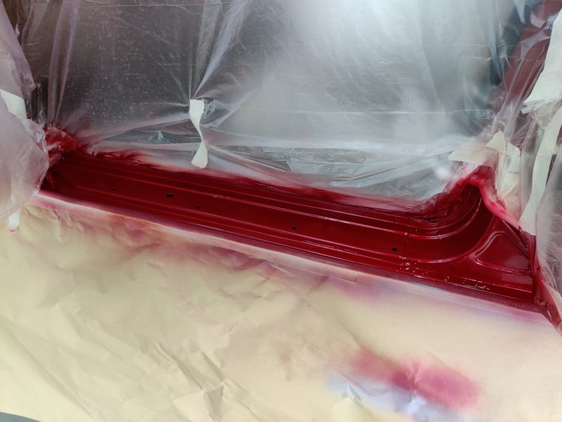

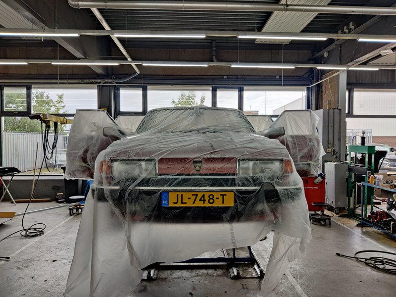

While i was sanding the Rover was covered but for painting i applied fresh plastic to prevent dust:
The stuff i chose to use. FLTR: rust preventive primer, normal primer, colour paint and the 2K clear:
On every bit of bare metal i applied rust preventive primer:
Then a coat of normal primer:
Colour coat:
And then i applied several coats of 2K clear coat on every sill:
Then i let the car sit and set for a few hours. In the evening we picked it up. It does look so much better with the correct springs!

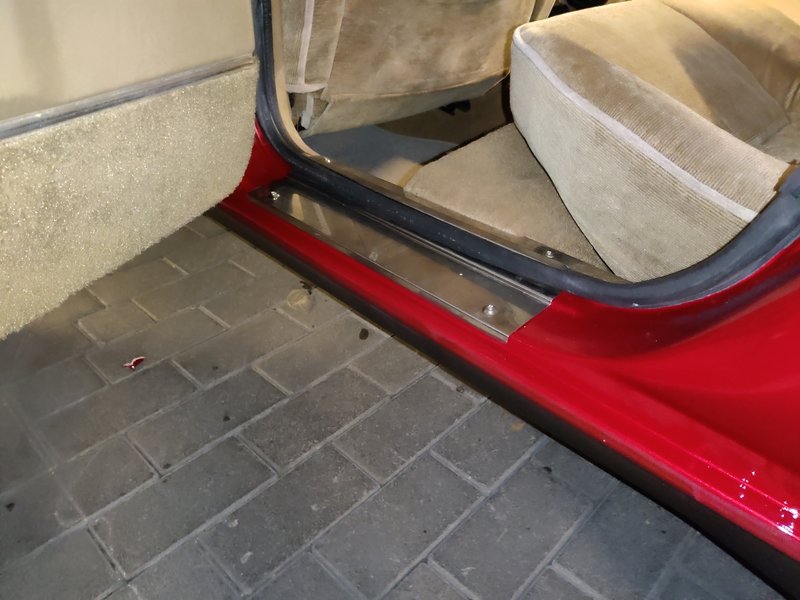

Continued the work at home when the paint cured properly. Sprayed some more cavity wax in the sills and applied body stickers to cover the factory holes in the sills, new screw catchers and then spray waxed it all:

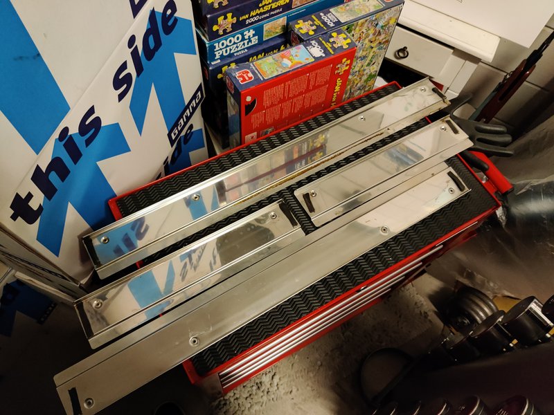

I polished the stainless steel strips before i re-installed them:
Rust hole successfully fixed:
It looks the business!:
