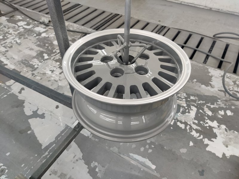

Winter is here so a good time to tackle another project on my SD1!
My Rover 3500 looks a lot better than it did but some things still needed some TLC. The wheels were looking very tatty.
Because i don't drive my Rovers in winter it was the best opportunity to do it now.

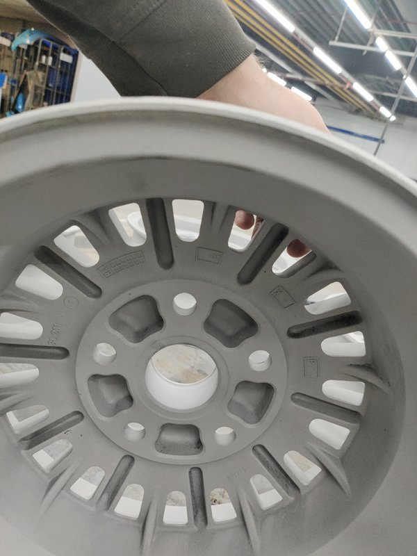

This is how the worst rim looked like. Paint peeling of and corrosion:

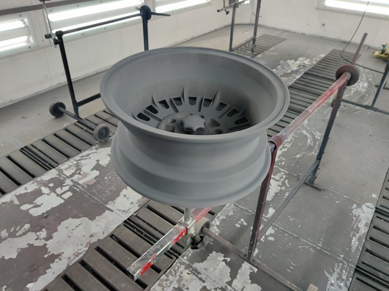

At first, I planned to sand them but because of the design, the deep corrossion and my big hands my colleagues adviced me to have them sandblasted. Good advice. After a week i got them back. A blank canvas:
After this, I applied primer so the painter could apply colour and clear:
Modern art :P :
Grey colour and 2k clear:

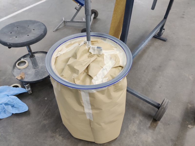

In the Rover factory, the edge of the face of the rim were then machined down to create the silver side. Then clear was applies. Because clear does not last that long on bare aluminum, and because we don't have a lathe at work, i decided to paint the edge silver (same silver as i used on the centre caps). Mask of and yes, that is a long job haha:
Silver:
And clear coat again:
And then leave alone for a couple of days to dully harden:

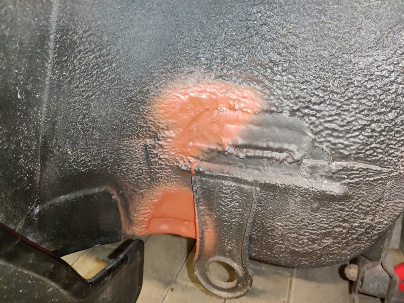

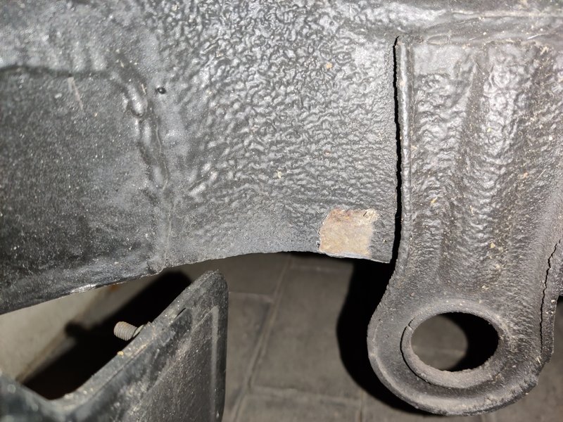

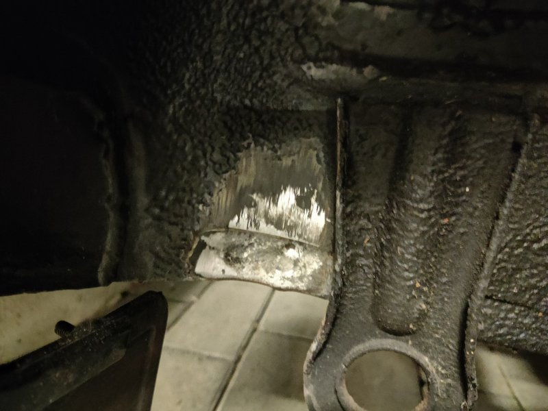

When I looked in the rear right side arch I noticed a small rust area that i overlooked during al the work of the previous years. Anyway, tackled it now:
Removed the rust to bare metal:
Rust preventive primer:
Degreased the area and applied seam sealer :
Finished of with black stonechip spray:

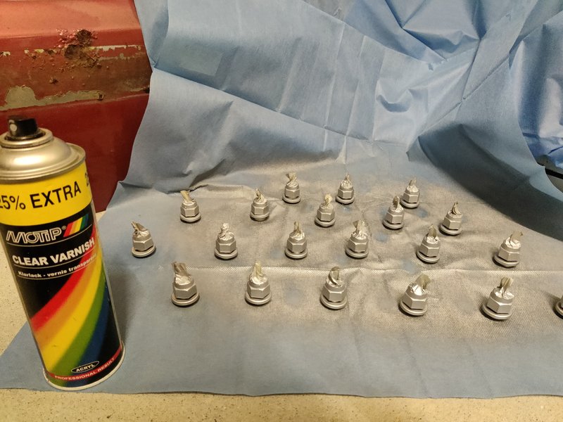

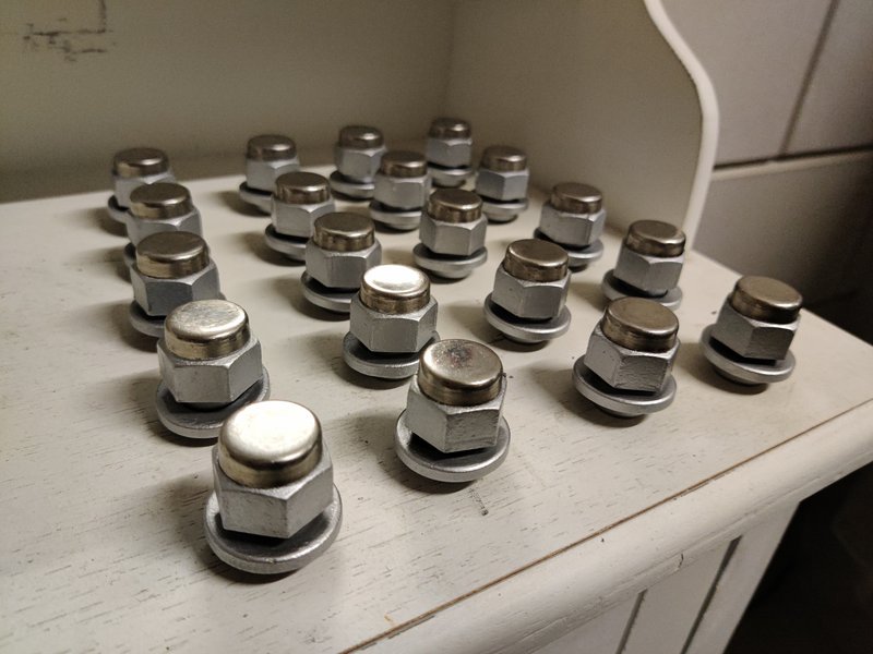

I could not resist to freshen up the wheel nuts. They are in sight so i removed the surface rust:
Primer:
Silver (Same silver as the rim edge):
Thin layer of 1k clear:
Fresh again:

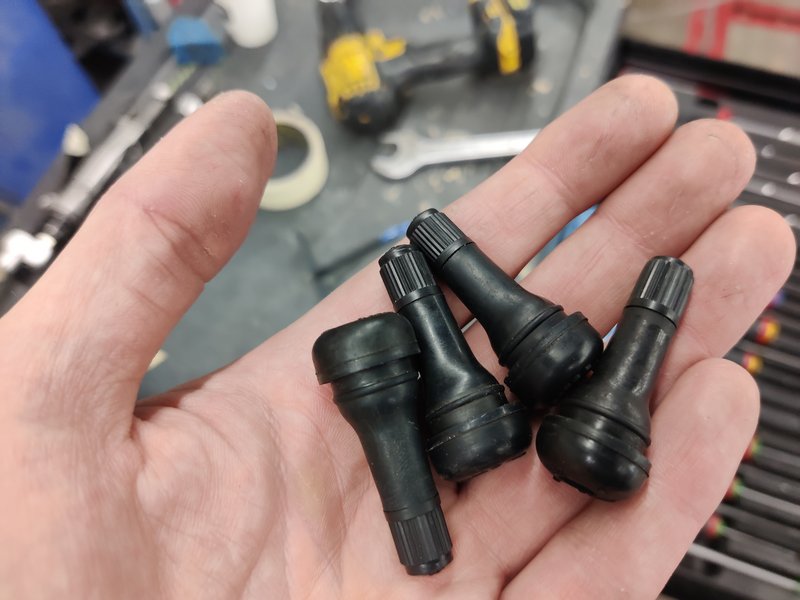

Re-assembled the wheels to start with new air valves:
Tires back on the rims, balanced and cleaned everything back home. Also applied tire preserver on the inside and outside. I also applied wax on the wheels:
Very happy with the result and very thankful for the help of my colleagues! :)
