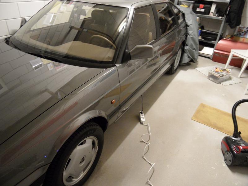

Last weekend was one of the last weekend's that had some good weather forecasts. A good time to prep my 827 Vitesse for winter storage. First a proper drive to get him nice up to temperature:
Filled up with premium and an additive to preserve the fuel. After this, i washed the Rover properly and pumped up the tires.
Safely tucked away for winter.

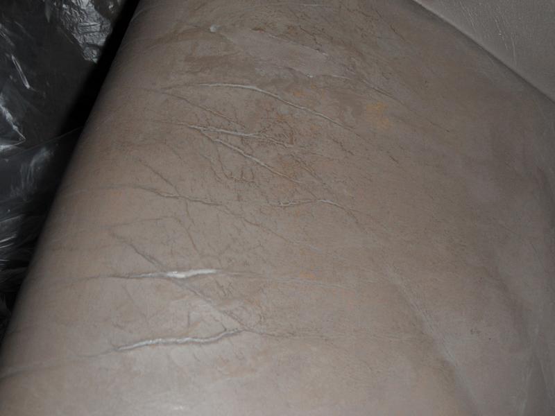

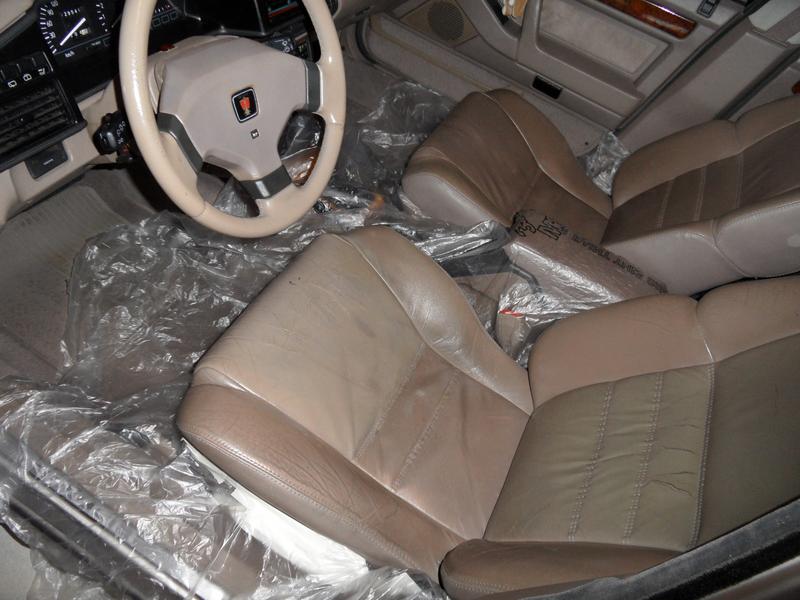

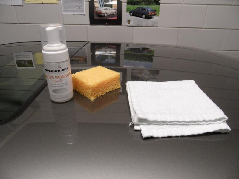

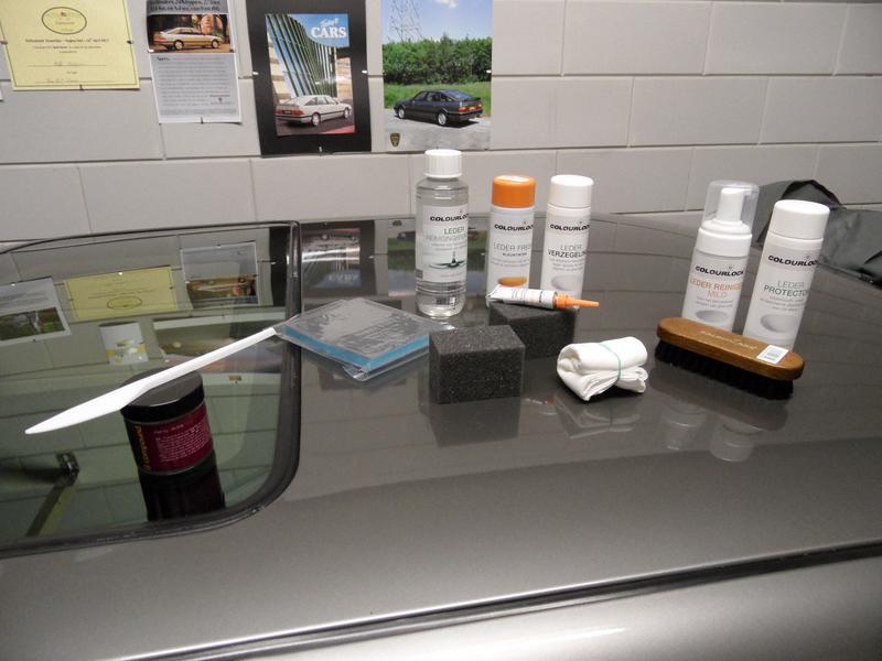

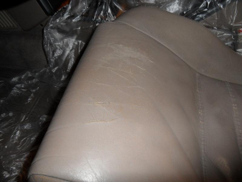

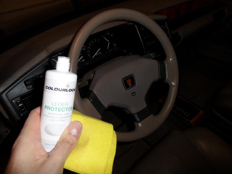

Like said before; i wanted to improve the condition of the leather seats in my 827 Vitesse. First i bought several items to help me. I contacted the same company who made my lovely floor matts. They directed me to a company named Colourlock.
The whole set (exept for the jar of filler on the left) was delivered by Colourlock after i sended a sample so that they could mix the proper paint colour.

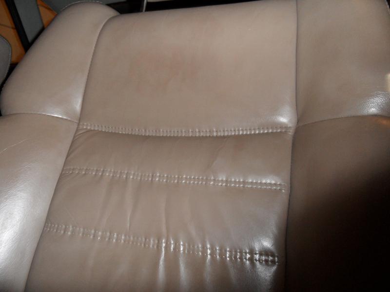

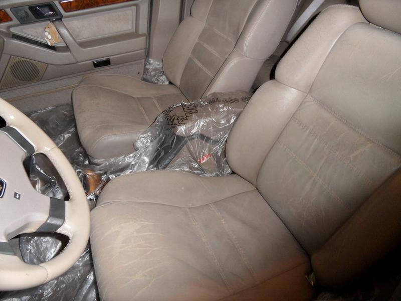

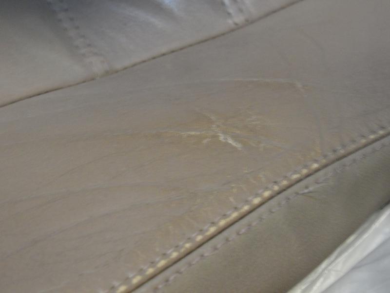

This is how the leather looked:
Drivers seat:

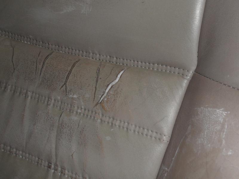

First i cleaned them properly. I was told you must start with the least agressive cleaner and work your way up when needed.
During the cleaning, i got to another tear in the driver's seat. After this i checked the rest of the leather to make sure there were no more. I also took the time to improve the glue on other tears i repaired earlier.

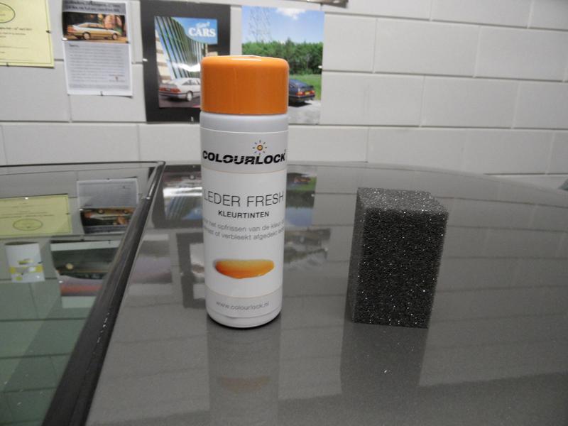

After this i sanded the leather to remove old imperfections, paint and rough the surface.
Then i used a more agressive cleaner:

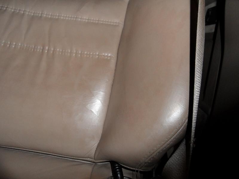

After this step it was quite clear that many areas were worn badly. Mainly the driver's seat of course.
Driver's seat side of the back rest:
Back rest of the driver's seat:

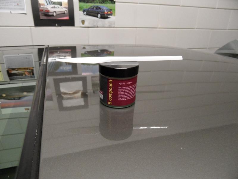

Then i started to apply the filler. The white thing is a plastic knife i cut down and sanded:

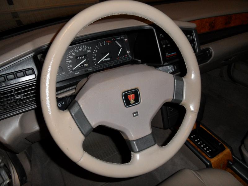

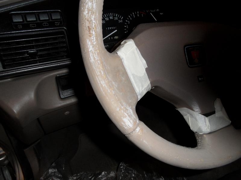

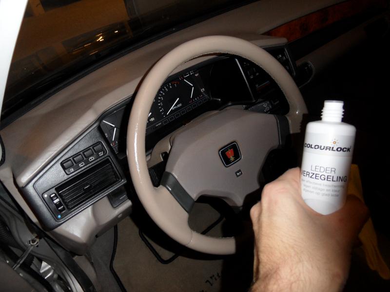

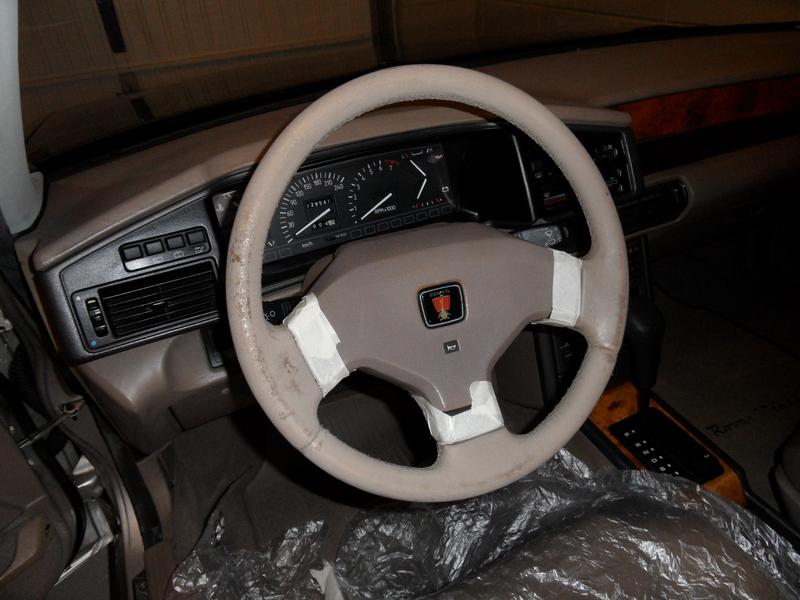

About 7 years ago, i painted the steeringwheel. It was a decent job but it was showing its age so because i had some paint left, i decided to freshen it up. It looked ok but up close, wear and tear was easily spotted.
Even a tear:
Mask of, sanding down and degrease:
I applied filler on the worst areas including the tear:
Then, it was time for paint:

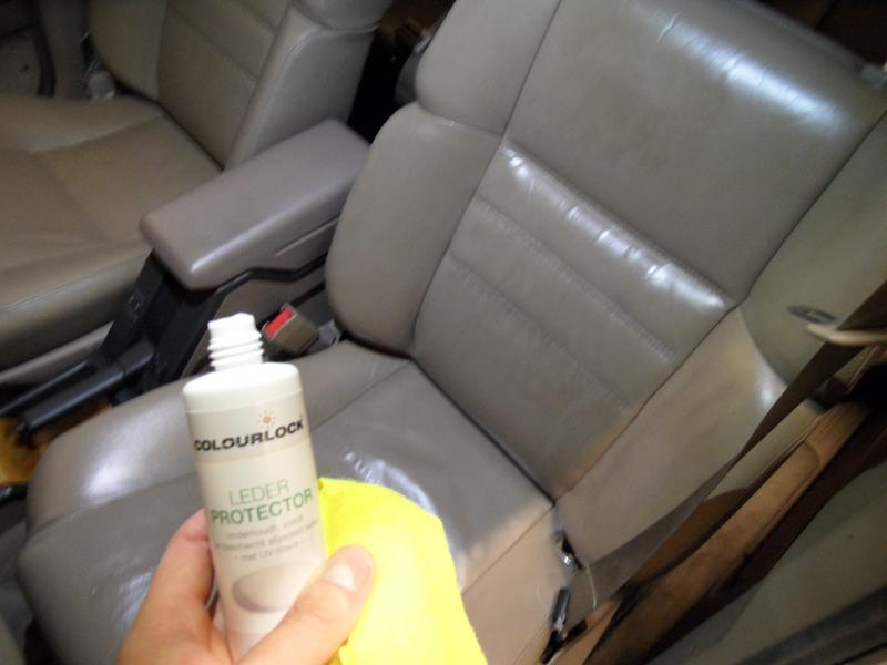

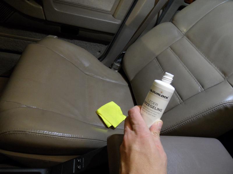

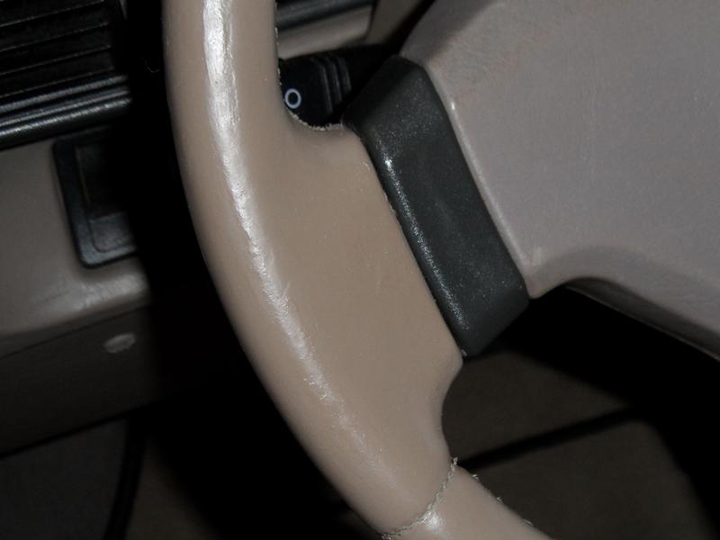

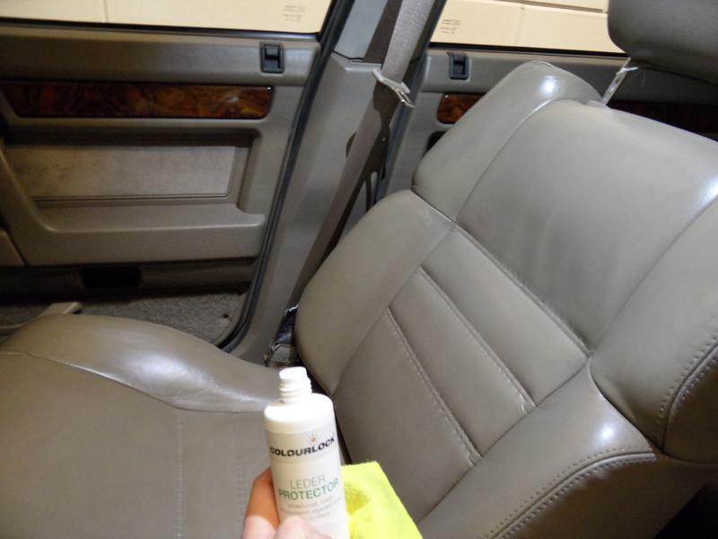

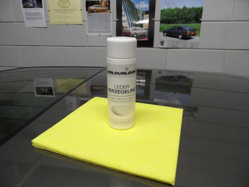

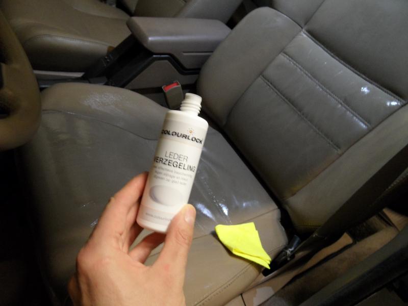

After all this, i applied leather sealer to both front seats and the steeringwheel. This is to isolate the painted areas as much as possible and help in a durrable result.
Driver's seat:
Passenger seat:
Steering wheel:
The final step was hydration creme:
Driver's seat:
Passenger seat:

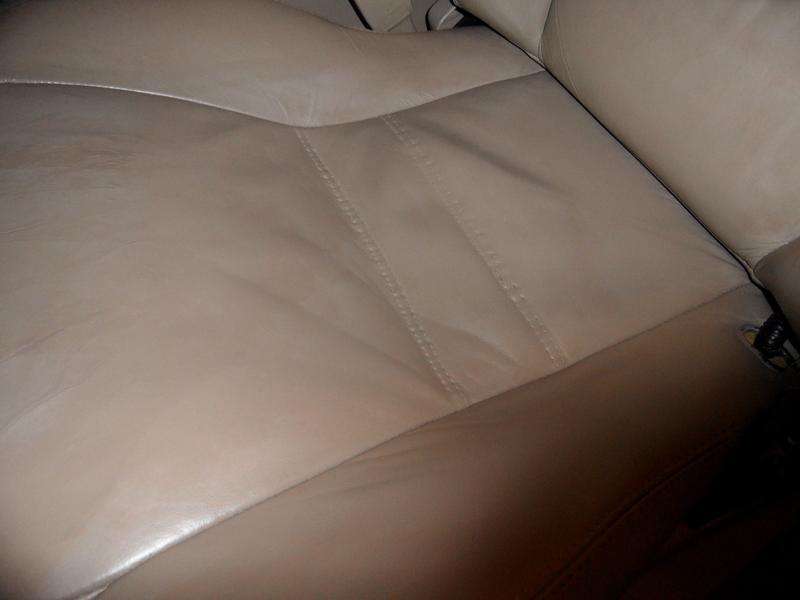

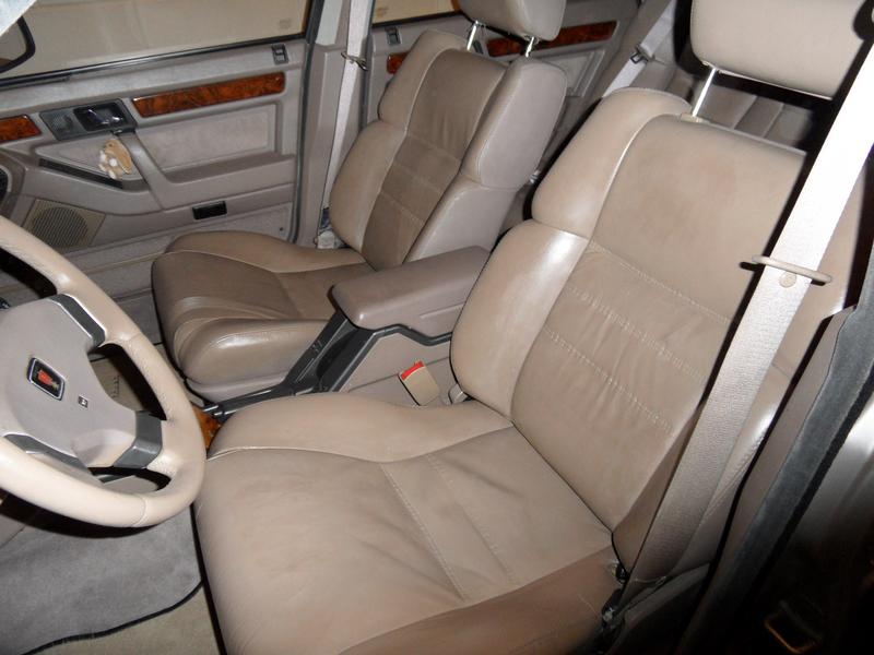

The end result:
Seat of the driver's seat:
Backrest of the driver's seat:
Side of the backrest of the driver's seat:
Seat of the passenger seat:
The steeringwheel is now in a better colour than before. It was always to light.
Tear is gone:
In the days after, i warmed/heated up the interior of the Rover to help the paint dry and set.
All in all, it looks fresh i think:
A profesional company would have replaced some parts i am sure and have a better reslut. But i am pleased and i had fun doing it. I hope it will be a durrable result. :)

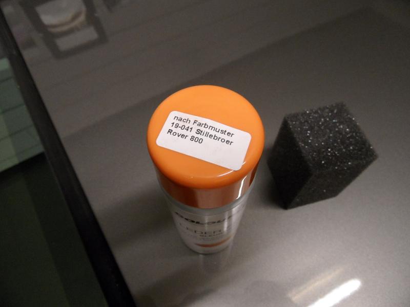

When i lived near Rotterdam some years ago, vandals vandalized multiple cars, sadly, including my 827 Vitesse. They damaged the rear spoiler. It was replaced by a brand new one and all was fixed properly. However, the paintwork was a bit damaged beneath the spoiler (covered when the tailgate is closed) I attended it some years ago with the knowledge and skills i had back in the day. Now i wanted to improve it.
This is how it was:
Because it is winter, i put my paint in a bucket of warm water to improve the atomizing of the spray.
Primer. Now properly masked so that no sharp edges form:
Colour coat. Sanded the primer and then masked of a larger area ready for paint:
After masking of a larger area again i sprayed on the clear coat.
Still visible but much improved i think:
